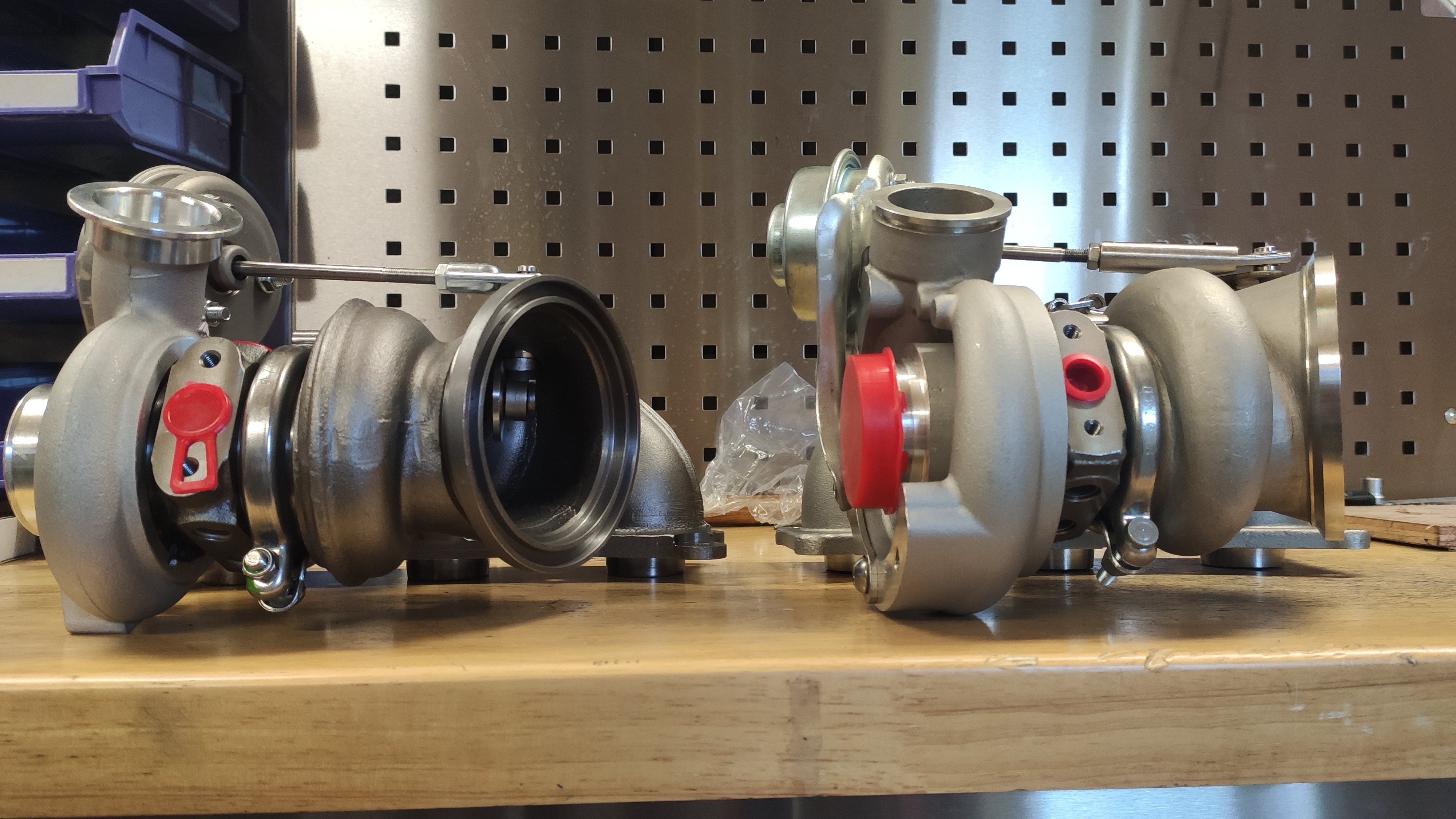

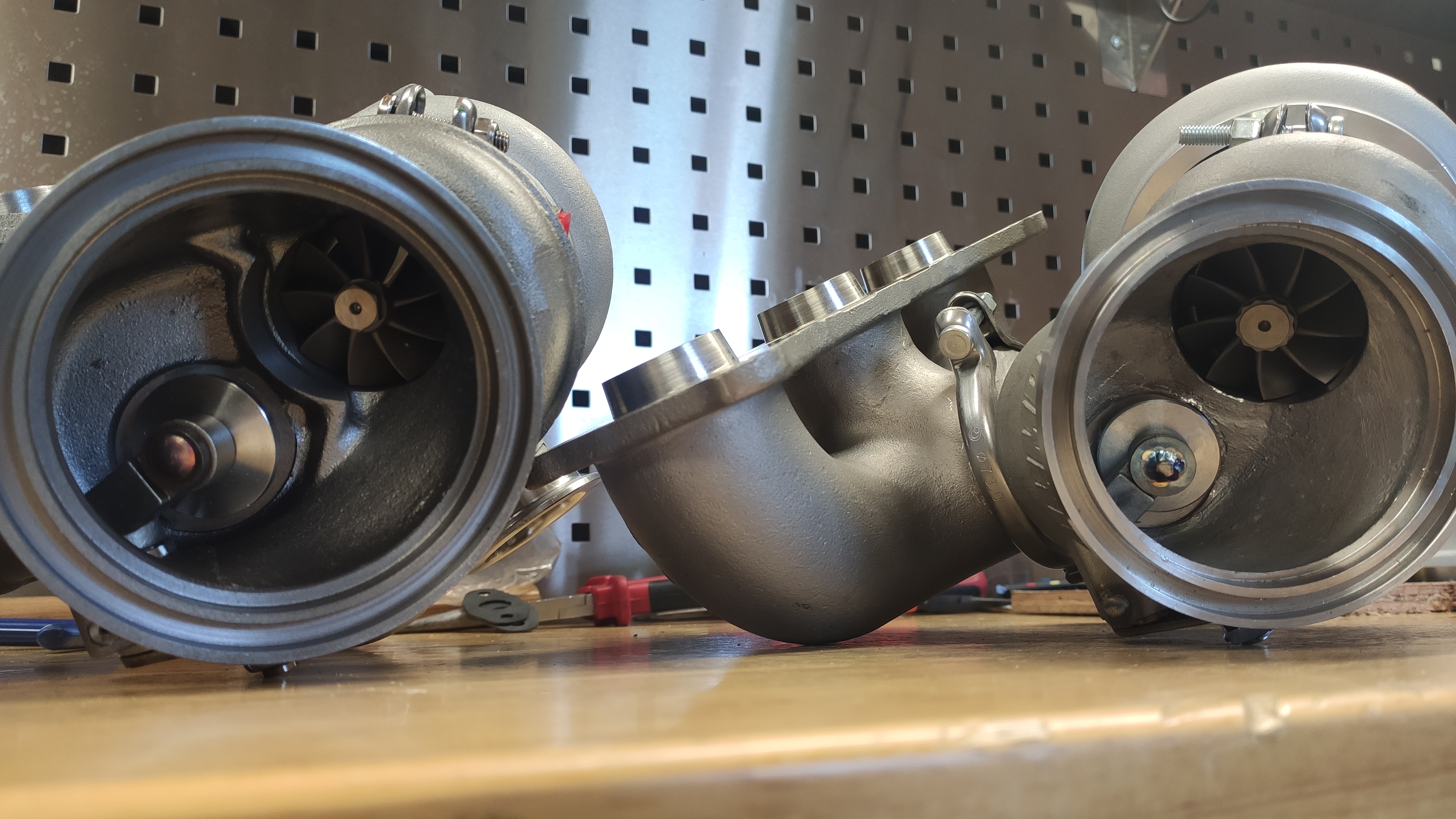

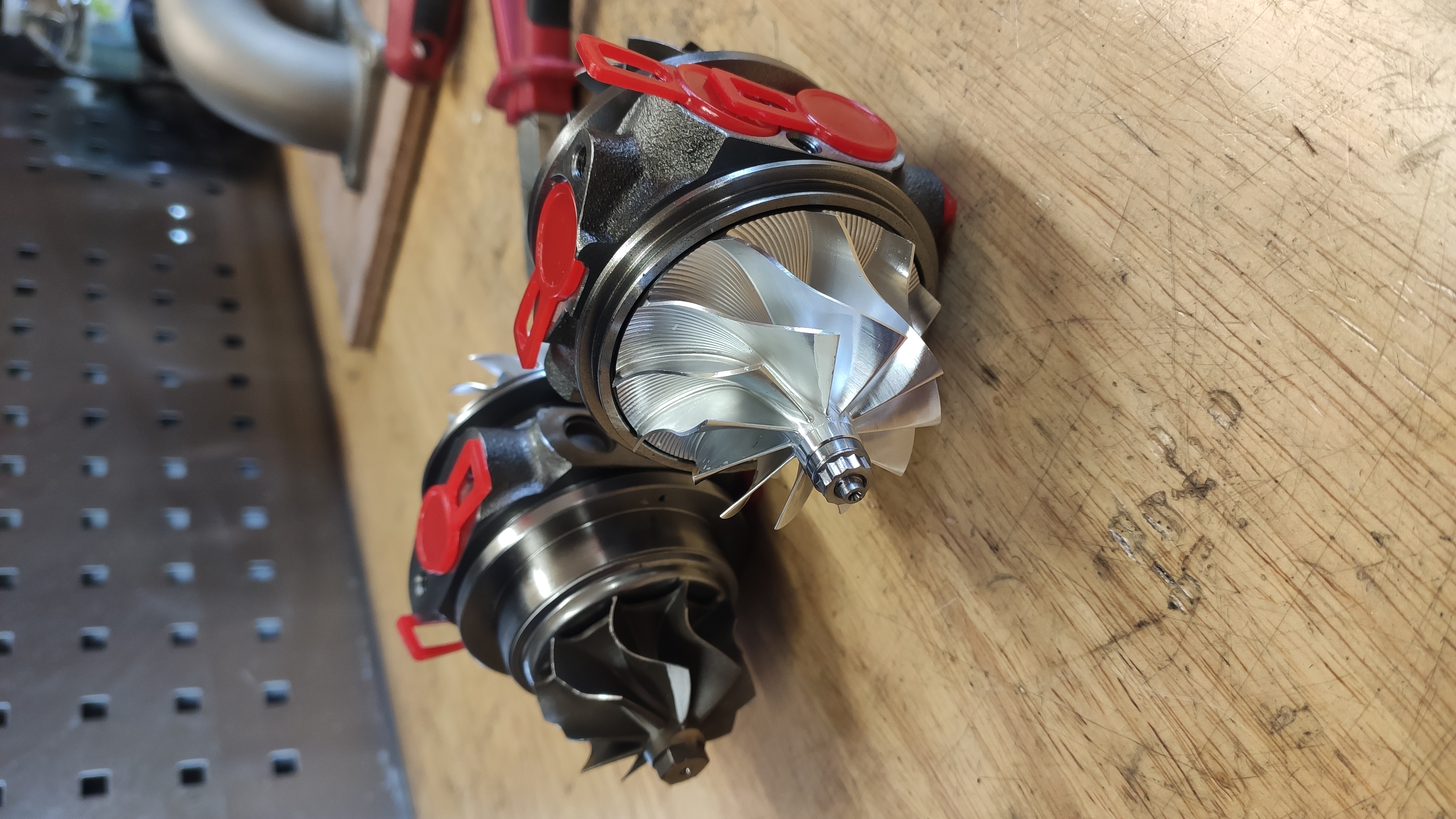

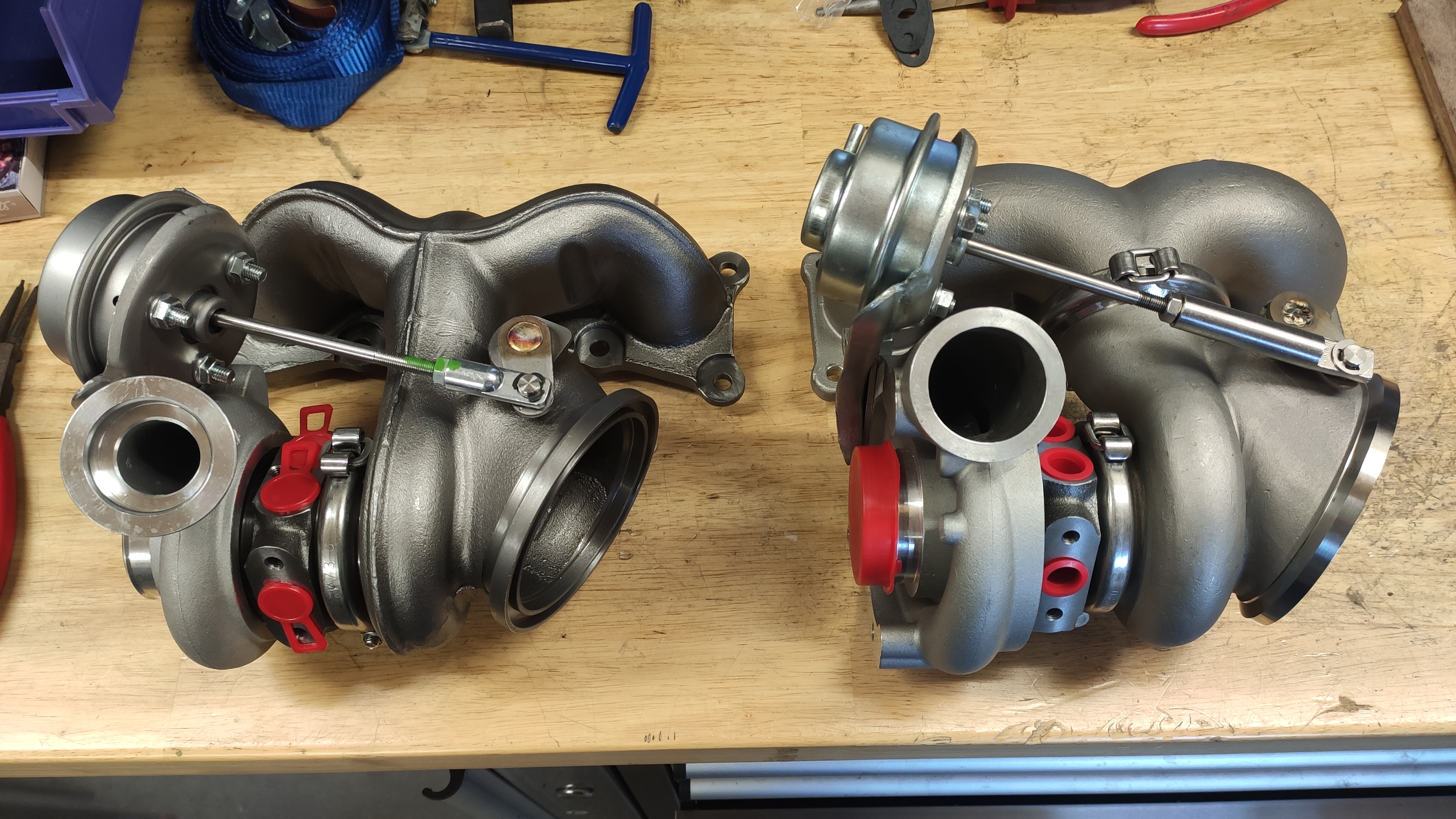

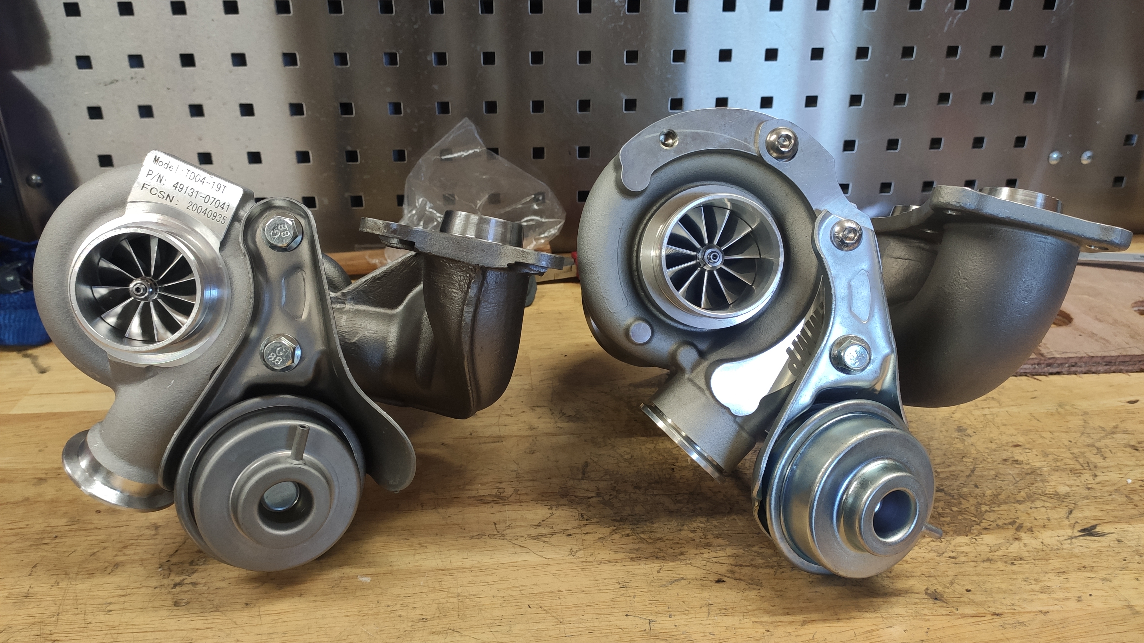

Thought i'd share an update on the new 19T cores with you guys.
Here is a sum-up/comparison of the things that I noticed: China 19T TD03 vs MMP 1K 19T TD04.
What does 3 times the price get you;
Updated CHRA's with the fixed oil feed mount. It's a shame they didn't fully cast the area around the hole but this is still miles better than the early version with the welded nut.
Both have 19T (46mm) compressor wheels as stated.
The China turbo has a smaller turbine wheel (17T 42mm) compared to the MMP 19T (46mm) turbine wheel.
An appearant difference in the quality of wheels is the size of the hub. The MMP bieng larger resulting in a stronger wheel/blades.
While the core itsself of the China is a bit smaller, the shafts seem to be of equal or near equal size and finishing quality. I think they learned from the bad shaft quality reports and also fixed this in the new revision. Ofcourse this says nothing about the quality of the material used here. The finish on the castings looks rougher on the china's.
Here the difference is obvious. The small TD03 compressor housing of the China's does not make sense with the big 19T wheel. Compressor housing exit is barely 1inch. This is a near stock compressor housing meant to be efficient at 8-12psi. Maybe a little more. While it's nice that things just bolt on, there is a serious flow bottleneck here stopping them from generating big and reliable power.
MMP's (also RB and Hydra's) have full TD04 compressorhousings with large exits. This does require a bent coolant line and proper fitting outlets (only silicone available at the moment)
The exhaust manifolds differ greatly. The china's compare mostly to stock manifold, I expect them to flow nice for fast spool but big chance they run out of breath eventually. The MMP's large manifold will increase spooltime but at high HP high RPM operation, I expect these turbo's flow like crazy and outperform the china's while doing so at 5psi less boost :)
I will no longer be fitting them as I still think these 19T China turbo's don't make much sense in choice of parts and still have doubts about longlevity I cannot take away. The 17T's make more sense. However, they still look like very nice turbo's to run at limited boost (read: not 24psi+ like many you never hear from again) and the ideal set for any stock replacement or stage1 upgrade.
