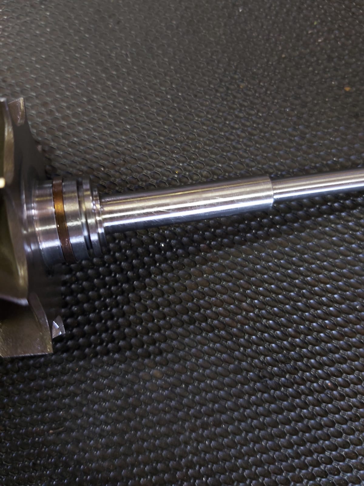

A bit of a update on my end.
Viv-Autoparts contacted me yesterday with the following.
  • The first batch of TD04 turbos the bearing housing was modified from other turbos.
  • A customers sample showed there was an issue with the oil fitting that was welded to the housing and this this could be prone to failure.
  • Viv-Autoparts asked the factory to stop supplying the 19T until this is fixed.
  • The factory is going to develop a new mold for the upgraded bearing housing to correct this issue.
  • Lead time is 20 days.
  • Picture below of welded nut they are referencing
While I am not in a rush to get the turbos installed it is a bit annoying so that means another month wait when you factor in shipping. JP works and China GTX3582r looking good right about now haha

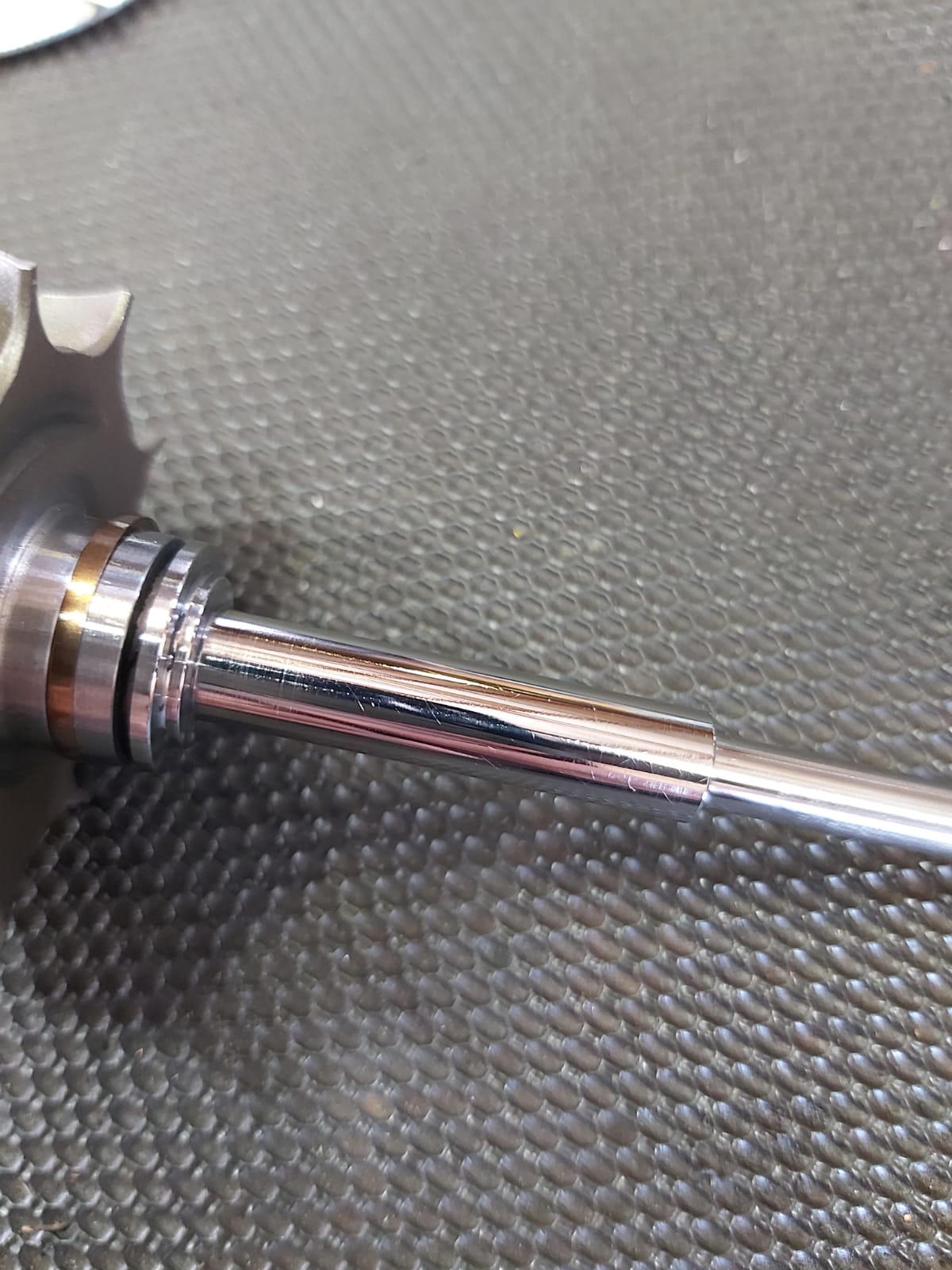

One of the guys fitted the 19t turbos
19ts First thoughts.
Fitting,
The guys at pmp had to replace and re weld nuts for oil feed as they didn’t hold at all. Outlets had to be bent/manipulated as the angle of the rear turbo wasn’t quite right.( silicone ones would be ok I think.) apart from that all good.
Driving,
The car sounds different from the get go. You can hear the turbos spooling up straight away.(good thing?!?.)
Turbos spool up quickly and car pulls hard. I haven’t pushed the Revs over 4K yet as recommended by pmp until I get base map sorted. (Doing tonight.)
Overall I’m pleased so far and have about 250miles on them already. Everything seems good so far. Will get map on ASAP and get some pulls done for you all to see.
