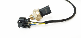

Also, has anyone figured out the pin layout?? Thinking i might just buy an N55 sensor from the dealer and a license from Nexsys as the shipping to the UK is expensive
eastsidaz
Nov 18, 2018
159
69
08 335i
It's easy to work out. The blue/yellow wire is the curved side of the sensor connection. yellow/white is middle pin, Black/yellow is straight side.
but of course it'll be your own wiring colours.

I need more help sorry
Fitted the kit today, purchased MHD monitoring app and added the Nexsys Licence.
Nexsys instructions say I need to flash the DME..... I'm only using the monitoring app as I don't wish to install any performance maps
What do I do now??
carabuser
1,063
1,225
UK
Z4 35i & 335i
What do I do now??
You need to flash stage 0 at least to get the changes in there for the sensor.
Out of interest, why wouldn't you want any increased performance?
1muk
Feb 9, 2024
11
Any advice on how to do that ? Sorry I don't have any experience with this stuff, and is this possible with just the monitoring app?
It's on my 1M, don't want to mess with it, just want a good oil pressure monitoring system/gauge as the OEM warning light is useless
carabuser
1,063
1,225
UK
Z4 35i & 335i
You could try just generating an update stock file, then using the flash custom map option and selecting the updated file that MHD created. You would have to ensure that the Nexus flash options is set in MHD first.
Since the stock tune you have only has provision for a pressure switch, not sensor, some kind of flash is required to change that.
