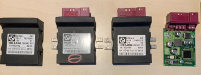

Bought 3 EKPs , two of the 046 version HW6 and the latest 513 version HW 7..
Boards look identical to this rooky..different firmware..back one one of the 406 boards doesn't show any obvious heat distress..will go with some better thermal pads between board and mounting plate.. 16 w/mk versus I guess 6 w/mk there? plus ic heatsinks on the main controller and choke and then same 16 wmk pad between box and bulkhead plus a few holes in the box..
