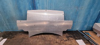

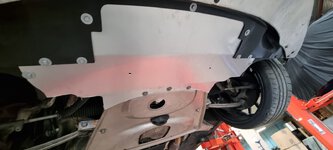

Finished the custom undertray today, it was the final piece of the undercarriage.
Now to get it powder coated.

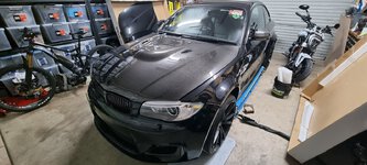

Seibon bonnet arrived today, didn't waste any time bolting it up to see if the airbox snorkel aligns and it did perfectly.
If looks could kill or the waiting time which took 7 months but it was worth it.
1,915
To paint or not to paint is the big question.
Might leave it until the cf starts to yellow and the bonnet goes through a few heat cycles in our extreme summers
Has any one had experience with painting carbon ?
I personally love the look of raw carbon. I like the idea of waiting until it yellows a bit before painting or if you do paint, maybe leave the bulge unpainted.
Reactions: martymil
1,915
I think Ill ppf it and ceramic coat it for now and see how it holds up to our brutal 120f summers
I love the carbon look too but the constabulary likes it to much and loves slapping defect stickers on cars that use them.
Reactions: NoGuru

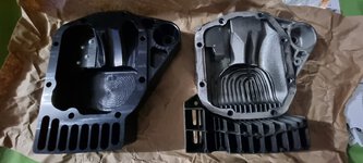

Our new diff cover is on its way, one more weak link eliminated.
I'm contemplating fitting a drexler LSD into the 1m so now would be the time to put this in as well.
Reactions: GreyNBlueE92

1,915
Yeah its a good video seen it a few years ago, the problem with the stock cover is it's cast and they crack.
I've seen a number of them fail over the years, we are building a drexler m3 lsd diff with 3.45 ratio for the single turbo kit 135
that will make close to 1k hp and just a stock diff for my 1m3 as I seen a few with hairline cracks in them or total failures like on
Tony's car pictured below. Prevention is cheaper than cure.
1,915
This shows the design differences and the oem is a work of art but the problem is its weak.
Under stock power applications its the best thing since slice bread but when you start adding
power to it will disintegrate.
The vac is quite a good design and I don't believe the difference will be that substantial compared
to oem but the strength of the mounting point will.
What I like about the vac cover it lets you add a temp sensor to measure the oil temps unlike the
oem cover, when you double or triple the hp of what it was designed for you really need to get serious
with data logging.
I already lost one diff and I'm not about to do it again, only time will tell.
Also the oem cover wont let you run anything over 3.15 gear set as you will have to grind it out and
there really isn't enough meat in there to do it, so you either have to shell out for a 3.85 oem cover
or buy the vac and it will let you run any ratio you like.
Reactions: fmorelli
972
675
Going by the videos of gale banks it is a significant difference between the vac with machined flat area and the oem area with the fins and remaining curved style. The vac cover will let the oil not flow smooth but rather splash it
