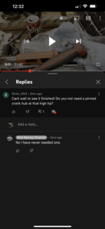

To Further add to this the boys over from N54 Racing channel ran the updated hub in there built motor with no issues. That car was a Xi Manual
758
Yes but not the motor is being sold off after the head allegedly lifted? Seems a little odd that a full 11mm headstud converted block is lifting the head unless your using an autozone head gasket
Wasn't a AutoZone special although it was a Elring.
