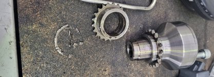

This was a custom 1 piece hub with a brand new oem slip disc and brand new bolt, I personally run the vtt spline lock and never had any issues. We are looking into fitting the spline lock to his car but not sure it will fit as he has a custom billet crank.

I spun the hub in my 1M when doing a log. At the time had hybrid twins with around 25 psi on E85. Was lucky that it was only a partial spin and the car just simply turned off and I had a heap of timing codes. We put a new timing set in it and its been fine ever since. Also have the VTT spline hub and the front plate as well

Custom hub and still spun the revised slip disc or what ever its called into a 100 pieces.
Vargas spline lock on its way, this is the only solution that I seen work without a single failure to date,
which will be used on this beast from now on.

Why not pinned ?
1,907
I've seen pinned hubs shear of on other non n54 platforms and I'm not convinced they are a solution, this revision of spline lock has had no failure to date and 1 questionable failure on the v1.
Stick to the one solution that hasn't failed.
Drilling a crank introduces a failure point on the crank as it makes it weaker, seen crank snouts shear off on other platforms in high rpm setups like this car has as its got a vac stage 3 head and shrick stage 2 cams revving to 8000rpm plus.
If the pinned setup was cheaper I'd consider using it on a stock head and cams but not here.

I can't speak for the vtt spline lock (haven't seen it), but I agree pins and/or shaft can still shear with enough force. A well designed spline should be stronger than pinning.
