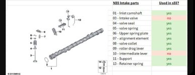

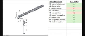

Just adding some more component cross reference information. The source was realoem, using my 2015 pwg n55 as the base engine for comparison.
