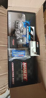

Then i received all my stuff for the built motor. And finished all the little stuff up top
