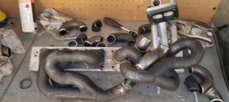

Heres a manifold I'm making.
Always wanted a long runner manifold so I'm making one.
Few photos of the progress.

You would have to be Houdini to get the lower nuts onto the manifold head studs Brule.
same here for my long runner. looks impossible but the trick for mine is to have some nuts made up to the studs and then make them up at the same time as the others, and one nut i modified to be shorter. and i'd rather slam my dk in a door than get my water pipe out again which is what i did recently...
Runner 3 bottom will require stud to be cut to get nut on it. Probably a half hour nut tightening session on that one.
The rest are alot easier then the other 2 manifolds due to the runner size and they all come off the head heaps which allows room.👍🏻
