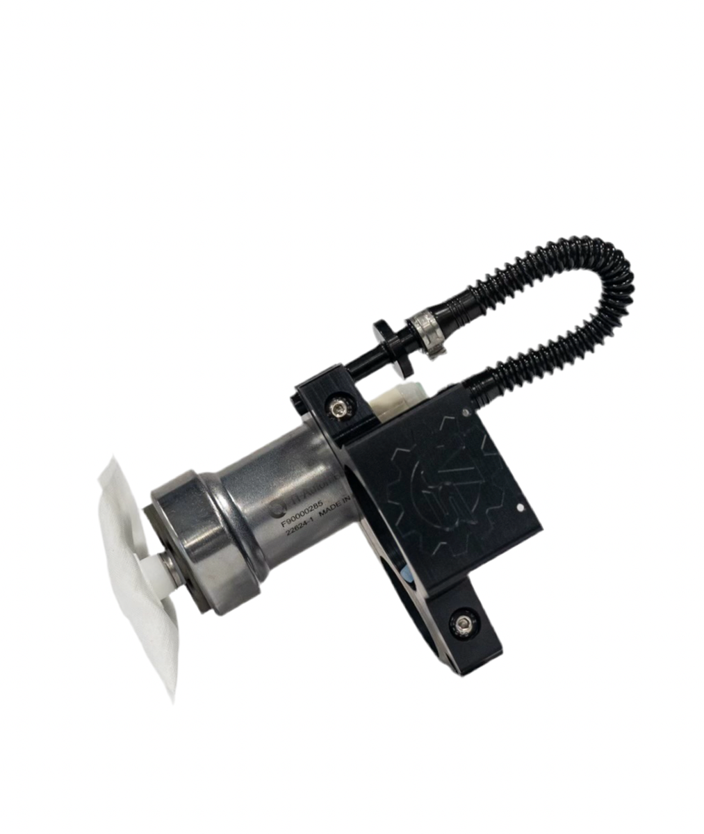

There is no core charge. Floater not included.
Will not work on a 5 Series.
