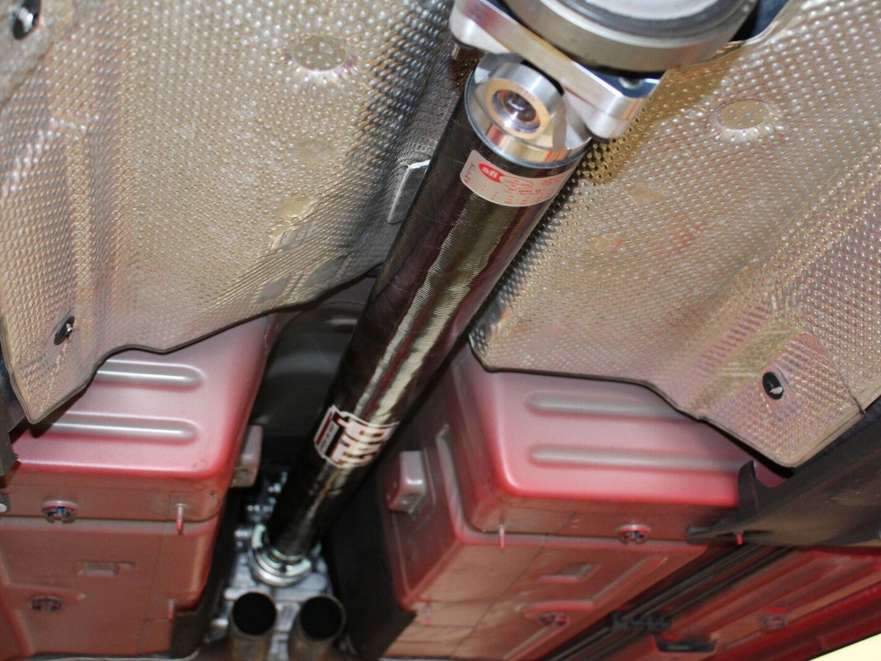

The mfactory weights in at 12.1 lbs total so when you consider that against 49 lbs from stock or even 32 lbs from dss its quite a weight saving in rotational mass
I haven't broken one yet but I don't launch at silly rpm's as I can guarantee my gearbox will let go before the drive shaft as its the weakest link.
The mfactory is way stronger than factory but not as strong as dss but thats ok as i rather have cf for everyday use as its not a drag car.
You really have to experience a cf driveshaft before and after to appreciate how much less nvh the car produces

If you need to look up the results of how much stronger the mfactory is over stock there is a thread on it, so yes its way better.
I dont know how the factory shaft came in at 49 lbs as mine weights around 21.6 lbs so from what your saying the dss alloy shaft weights more than stock ?
There was a good article in dragzine about the benefits of cf shaft.
Another good article stating the advantages of cf over alloy.
He is quoting the weight of the DSS Chromoly, not the CF. The CF DSS weighs about the same as the M-Factory and is much stronger for about the same price. But it is a custom piece. They do not have them on the shelf like M-factory. I have 3 of them. one for 6-MT to M3 diff, one for 6AT to M3 diff, and one for Samsonas Sequential to M3 diff, which is unusable because when the diff broke it broke the CV joint. I currently have a DSS Chromoly shaft on the car now as it was quicker to get.
The weight is in the cv joints not the shaft itself, I think you will find the dss cf unit with a cv joint either side will still come in at at least 20 lbs if not more which will still be beneficial over stock if you need that kind of strength.
Most applications would benefit from the weight saving and the strength over stock with the mfactory unit, the weight is in the bearing and without having the DSS unit on the scale we are both just guessing how much of a saving that will be.
No one is disputing the strength of the cv joints but it comes at a weight cost and that has its drawbacks.

Have you weighed both? Because we have. As stated the difference is minimal. Why you are so stuck on this M-factory as being the end all be all when it isn't is a little confusing. Two CV joins on both sides so the driveshaft can have the proper angle is the correct way to build a single piece driveshaft. Ps, both M-factory broke on the dyno, not launching.
Well I did weight the stock and mfactory shafts and posted the results with pics to back it up never seen any for the dss units to back up their claims
I'm not stuck on it at all and can have any version I want but I rather have the weight saving whilst still being stronger than stock
