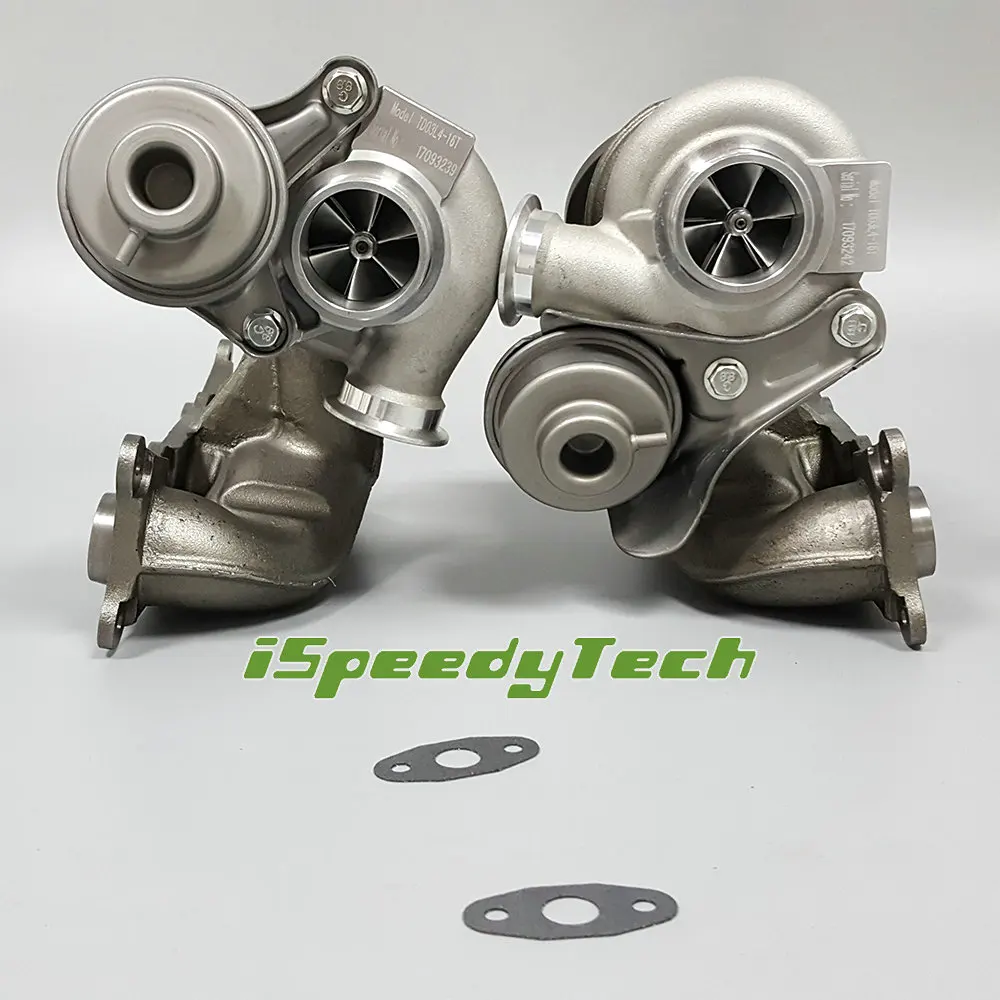

As you bought off ebay you are protected, just raise a case in Paypal and get your money back. Is it definitely turbo siren? Have you got a video? Boost leaks/pipes split sounds like siren too and will also be a reason for no boost.
I almost expected at least one failure since last summer when these were released, and was more surprised up to now there were none. But to be completely sure, make sure you have no boost leaks / split outlet pipes.

And something else wedge can confirm. In the last the last 3 months only got to v2 (v3 was on when they started siren) of the custom map because I was hunting for a boost leak that wasnt actually a boost leak (long story short) but the logs he said looked really good... I dont believe running the not final version of the map this long would cause a failure but maybe this info is relevant for somebody

Defo sounds like siren. What will you get next?
I guess you could replace the chra, or ask them to send you another pair of turbos.

Update: I have actually ordered a new set, 17T, this time from the seller recommended here. I will be VSR balancing them as an extra once they get here.
As I am in Europe there is no option to get some decent priced turbos. I"ll see how this works out.
To repair the 16T costs almost as much as ordering a new pair...
Maybe there is something I should pay more attention to when I install so this does not happen again.
Any advice?
I will document with photos the old ones when I take them down. Maybe somebody will tel what went wrong...

The thing with theses is, you have literally no idea what the internals are, unless you break them down. These guys aren’t making these with true td04 spec’d wheels, as they all spec there wheels to each of there own. You at least hope all the internals are td04, which would make these rebuildable, as long as the wheels are good. I’d like to see what these look like and the reason behind the noise.
