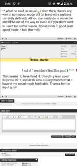

Can I still use DLS and lower BRO to avoid exteme lean stuff?
