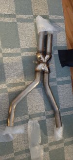

What about the Z4 35i exhaust? There is a ridiculous thinning on the right side of the exhaust after the catalysts. I ordered myself a FOX x-pipe to replace that thin part. I wonder if that has an effect on power. Random image from the web.View attachment 62698
Hello have you got your system fitted? Thinking of getting the whole cat back system..

Not yet. Too cold in my garage -18C to do anything. Maybe later in the winter. Which silencers did you intend to install? I have to decide for myself which mufflers to install. A terribly loud muffler cannot be installed to get through a Finnish car inspection.
I was planning to go with the Fox silencers with their rolled / slash cut tips
