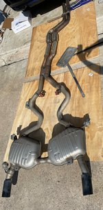

For reference here is my exhaust…since it’s down while I make a career out of doing this dang clutch an turbo swap…hindsight I should of staggered the resonators it would of fit cleaner…an makes no comments on my globular welding skills probably 20 years since I welded.
