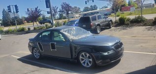

And for laughs: the reason im in this mess, (and why I paid nearly $10k USD in body work):
Some rub-a-dub lost their stove top (out the back of a pickup truck) on the freeway and hit my car. At 75mph, it bounced up and destroyed the entire passenger side.
Long story, short: the work was so expensive, I eventually had the body shop halt and I took the car home unfinished.
I think (now that I reflect), what happened is I took the car home with the passenger door panels disconnected. The disconnected airbag killed the BSD line, and the ECU refused to charge the system. The lack of power then led to the systematic failure which killed the water pump along with my instruments
