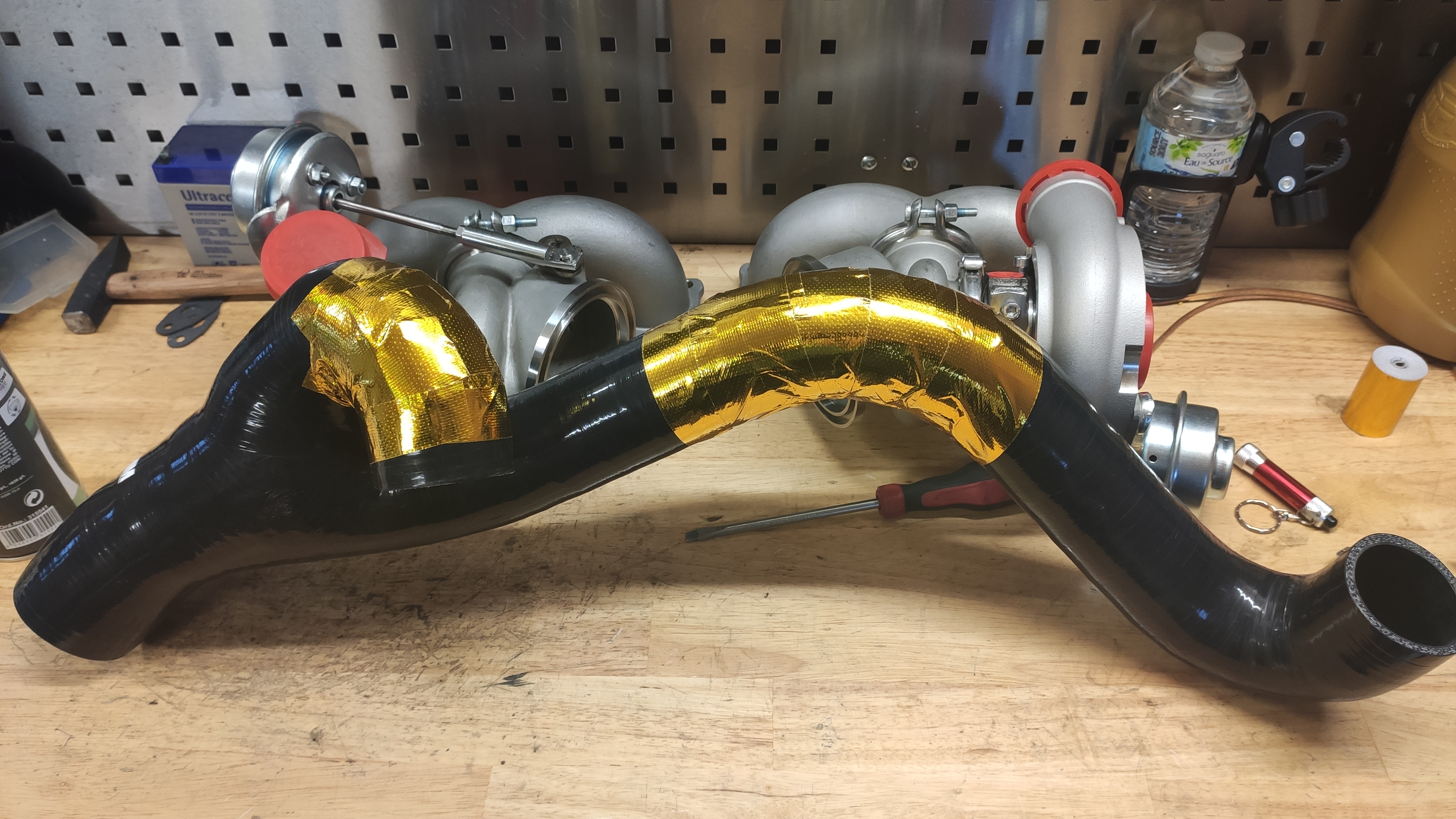

The only thing the small TD03 compressor housings (stock, china 17T, china 19T, Pure, etc) is good for, is fast spool and the ability to use aluminum outlets. Be aware that these alu outlets are not full 2"but rather something around 1.7 actual inner diameter and will be a possible limitation when you do manage to get them to fit on TD04 housings.

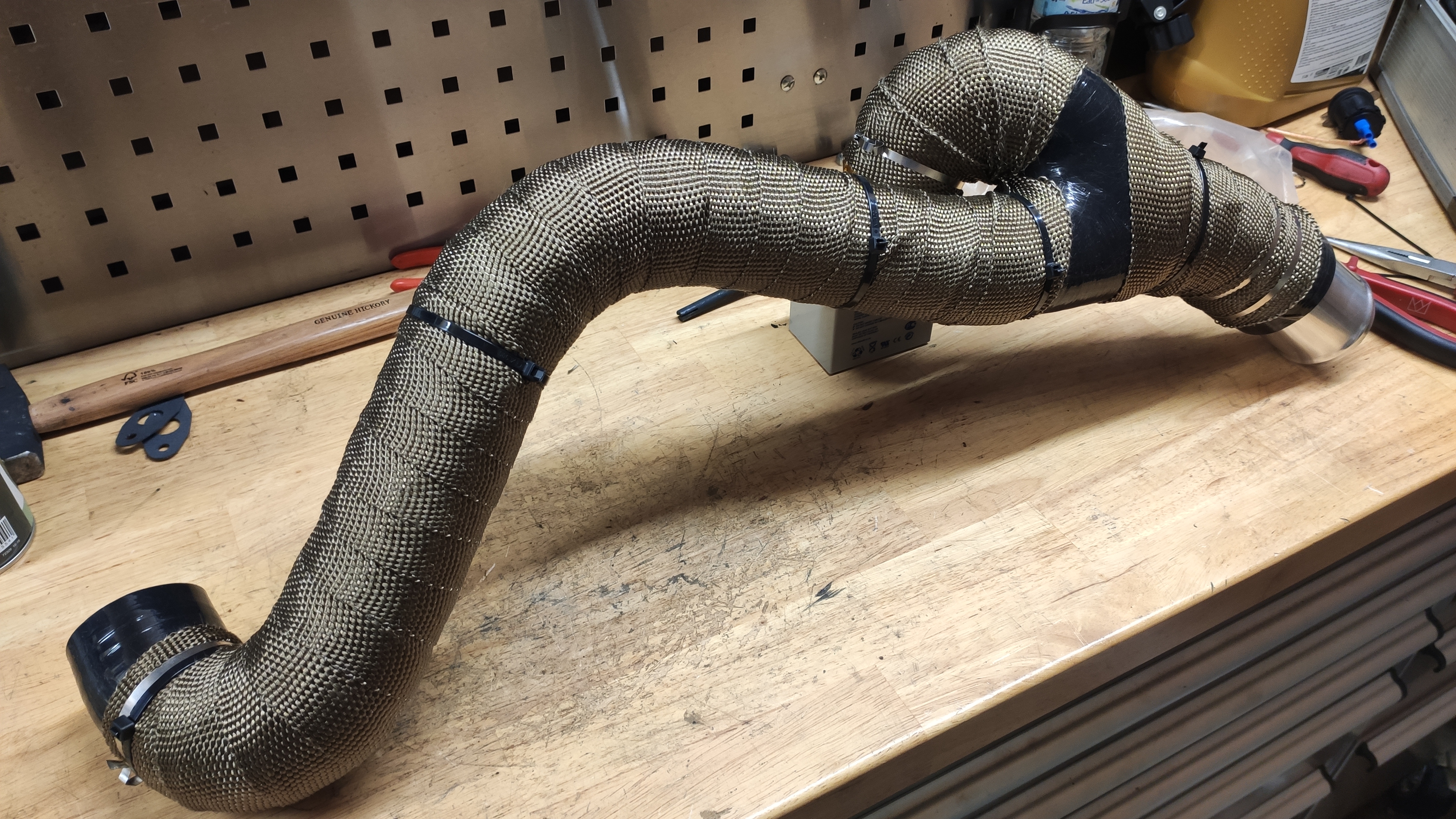

When moving on to TD04 housings (RB, MMP, Hydra) you'll need to use silicone outlets. You get true 2" outlets here. By now it has been established that ALL vendors silicone outlets have a melt and rip risk as installation is tricky and it's even more tricky to keep them in that position.
There are several remedies for this. One is heat reflective tape, the other is exhaust band. I haven't tested by outlet yet but i'm pretty confident that I won't have any issues:
Yeaaaaaah, I tried that with the MMP outlets. I had gold foil as well as the actual fiberglass/metal DEI shielding on the outlets. Still blew up.
I think the lack of aluminum outlets for the 2" size is brutal. :(
