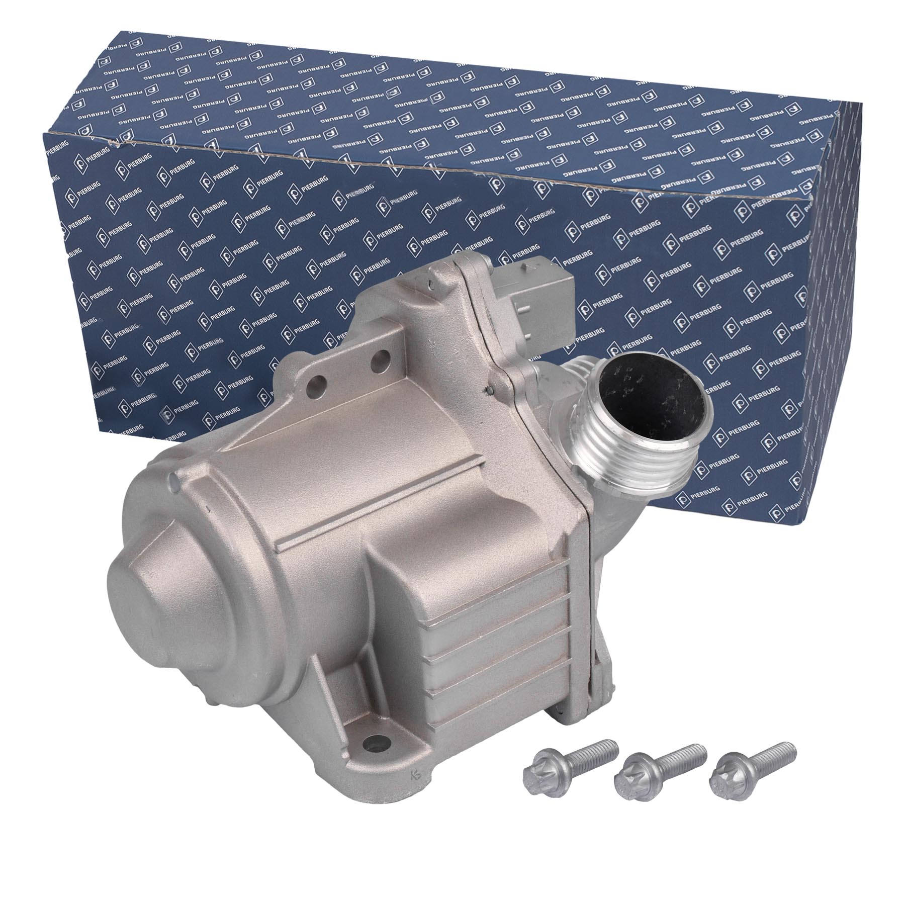

New N54 All Aluminum Water Pump
ShocknAwe

Just because the pump is aluminum doesn't mean it's better. Just word of caution. No way to know how long these will last. My original "cheap" plastic pump survived 80k of daily driving in town miles.

The pump he installed is definitely for N54. We need more info. I think mine cracked already and its only been used like 8k miles -_-

Just got my pump in yesterday. 100% not plastic. I'll give you the title to my car if you bring it to a metallurgist and confirm lol.
Build quality: ?/10 (because longevity)
Fit: 10/10
Warranty: Lifetime replacement (just warrantied my old pump at o'reilly. Got this one.)
Again: I verified myself that it's aluminum. Scratch it and it leaves behind more metal. Now it's just the pump motor that we'll have to see.
Didn't take a photo of the plug, but each pin was insulated from making any sort of contact with each other and the housing.
Finished the bleed cycle and the pump sounds exactly like a new continental pump. No leaks anywhere so that's a start

ciscogomez
Oct 22, 2020
Rock Auto sell 2 of the N54 water pump full aluminum housing. I just ordered mine brand Gates and I think they have another one brand Airtex
758
Aluminum pumps proven to be any more reliable or durable than the plastic continental?
