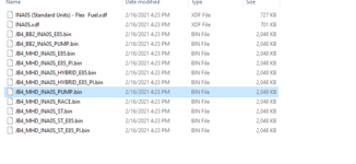

So If I'm running 91 octane pump I would just use the pump map from the JB4 BEF map pack? The thing I'm confused about is are all of these maps intended to be used with hybrid turbos regardless of the bin file name excluding "hybrid".
