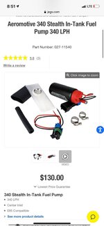

Buddy of mine who is living my parallel life, down south ... seriously ... saw my Z4 build and was inspired to buy a matching yellow Z4. But that's where it ends. His prior car was a big WHP Mustang drag car. So not long before he swapped his Z4 to a down single turbo. Now he's working the fuel system. In-tank Z4 he's stuffed two Aeromotive 340 pumps inside. Looking forward to seeing this running.
