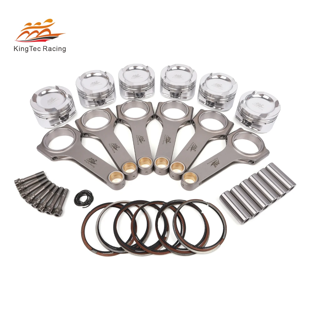

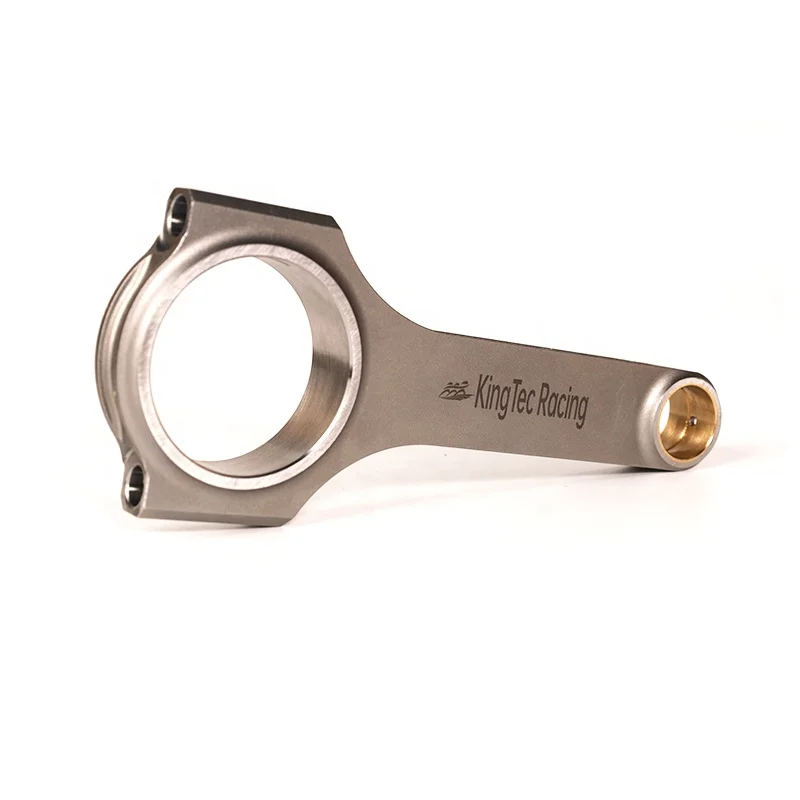

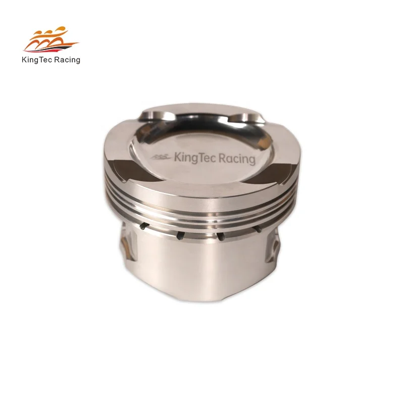

The $1,000 total price is what's making me think about it. I'm the first to make fun of Chinese stuff but the fact is these are metals manufactured in factories and Kingtec happens to make a lot of pistons and rods for a lot of cars. I've searched for negative reviews of Kingtec and I haven't found anything yet. They make pistons for Toyota Saab Honda BMW Mercedes skoda I figured with them making that much stuff if the product was crap I'd find a bunch of bad info about them. So far I found nothing in the way of negative reviews. I also look at it like my VIV turbos. They are made in China and people dog them, but the last set I had ran hard for 4 years and they still have no shaft play. I simply had one wastegate weld break. I don't simply trust them for no reason, I just figure if a company makes 100,000 of these parts a year, then they're probably pretty good at it. I also found some reviews where they weighed them and they seem to be very balanced with the exact same weight for every piston and Rod. I'm kind of looking at it like even if they're no better than stock, my stock ones are very old and have run many heat cycles so even new stock quality ones would be better than old stock ones in my opinion. Do I think they're even 1% better than Mahle or JE, etc. no way. But so far everything I've bought Chinese for my car from charge pipe blow off valve intercooler and turbos has worked and lasted just as long as other people with name brand stuff. The only reason I'm apprehensive is because this is inside the core of the motor.
