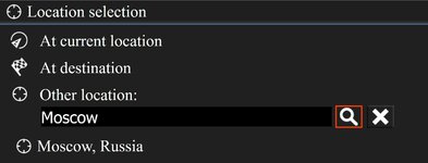

Yes it does, with the singular purpose right now of replacing dpas_00*.xml with your own proxy IP.
I spent about a month's spare time (Most of it I wasted with the mv2trace and bin) on this project between early June and the end of June when I essentially parked it. There wasn't that much interest in it and I do have a full-time job.
Here are detailed screenshots of what I built anyway. Code hasn't changed since Jun 30 bar for a move from Apache to Lighttpd yesterday.
I will release this with a Github repo that will contain the up-to-date web code and in the repo I'll link to the VM I run locally since I doubt many people will want to go through the whole hassle of installing. This makes the most sense to me.
I am considering a small lightsail instance but I just know it'll get DDoSd to shit.
