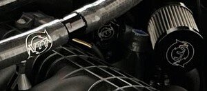

Hey Marty, or anyone in that matter, I am taking apart and checking my PCV system to make the changes we discussed and noticed on my high side my can looks like it has not seen one drop of oil at all, It still looks brand new. The check valve was pointing in the right direction towards the can... it was sitting in between port on valve cover and the can as you can see in original photo. What am I doing wrong and what does this mean? I was planning on replacing the 2 one way check valve with the vibrant inline valve that is metered on high side, and on my low side got the radium ORM PCV valve. going to have all new braided lines. but just wondering why my high side can is just pointless right now?
my low side can was full.
I also attached a picture to show you.
setup will be
high side
valve cover-10an hose -vibrant inline valve-can-filter
low side
valve cover-8an hose -can- Radium PCV Valve-6an hose -intakeManfoild
I also noticed the last week, my car been hesitating when when i first tried to hit the gas from a stop when i am idling. A few times it flat out died. dont know if this is related to something
That's normal the high side is there basically just in case now days, the only way you will see oil in there when you get a serious problem with your engine and that's why I kept it.
Because you had the low side on top of the timing chain it will suck a lot extra oil in because there is no baffle there.
On the rear port the cam box acts like a baffle minimising oil being sucked into the catch can.
The low side always fills up quickly, you basically have to empty it every time you fill up and that's pretty normal too when using such big hoses and valves, I found using a an6 hose reduced the oil in the catch can a little bit but I had to use adapters.
Your better off using the bigger stuff and just emptying the catch can more often.
Reactions: Mvaccarelli01

Got it thanks for the info, will move low side to back port for sure.
