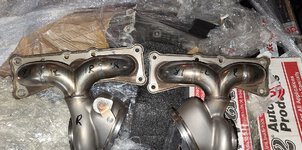

Speaking of N53 heads, this is the new engine i need to install.
Fully ported N53 head, with matching increased diameter tubular exhaust manifolds to go with Hydra turbos.
Shrick low lift cams, Supertech valvetrain.
Mahle pistons stock CR
ZRP I-beam rods
Fully closed deck
Pinned crank hub
Sorry for the shit pictures :D
ZRP I-beam rods
Fully closed deck
Pinned crank hub
