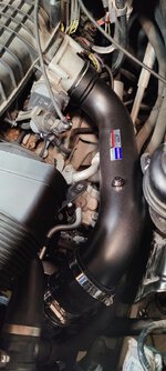

My MAF sensor is mounted on the new chargepipe which goes all the way from FMIC to engine. Do you mean that the MAF position on the chargepipe is getting flow values that is somehow unexpected? The chargepipe is designed for this engine so I assumed it should be transparent. I will attach pic of it.
From engine health perspective, it probably depends a bit if the high wgdc% is due to a boost leak vs. some other issue (boost solenoid, vacuum, wastegate rod adjustment, etc.). But worst case, it's a boost leak and you may potentially shorten life of the turbo since it's actually running harder than it needs to since your're moving extra air to compensate for the leak (higher pre-turbine back pressure, higher pre-turbine exhaust temp, higher turbine speed). Is it enough to matter? I don't know, probably not much of an issue if it's just a daily driver. You're corrections look decent so I wouldn't be worried about damaging your engine.
With the MAF sensor, it's taking a sample of air from the cross section of the intake duct where it's mounted. So if you change that cross section, it changes the proportion of air going through the sensor, so it can throw off the DME's air calculation. You can adjust for it with a custom tune, but I believe the OTS tunes are set up for the stock intake. It may not throw it off enough to matter. I've seen lots of people have codes and idle issues when running the Burger intake on OTS tunes, and then others don't seem to have a problem with it. Personally, I've decided to just stick with the oem intake to avoid any issues, plus it actually works pretty well, and doesn't seem to be a bottleneck at OTS power levels.

I have the FTP intake, it seems to not affect idle or anything else I notice. But as you say, the OTS map is probably only tuned for FMIC+downpipe so it's overkill for my setup. But it looks good ...😏. A pro tune just for the sake of the intake is overkill I think. Concidering it's my summer/project car and it has almost 70k miles on it I think my conclusion will be it's safe enough to run with this. Drilling into the logs really gives a lot to think about, in the end it's all about risk versus reward I guess. N55 really is a torque monster, that is rewarding.
