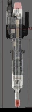

I have been working for sometime on figuring out how to make N54-powered cars easier to own and maintain. I currently own a 2008 E61 that I got at the end of last year, but this would be my third N54-powered car in the last 13 years. As I'm sure most of you know, some of the most aggravating issues of the N54 are related to the DI system. It seems to be the case that HPFP issues have been sorted by BMW in later revisions of the pump. Our fuel injectors, however, still need considerable attention considering how common it is for them to leak. I know how a $2.5K initial investment for lifetime injectors using one of the two vendors we know of may be reasonable for some, but I am not sold on this path. Which brings me to what I am working on right now:
I decided to find a way to run Bosch HDEV 5.2 solenoid direct injectors (the ones on the N55 and newer BMW engines) and this is what I came up with:
1. The injector bore on the N54 is about 1mm smaller at the top than it needs to be to accommodate for the HDEV injectors. The bore would need to be increased to about 21mm at a depth of at least 27mm from the piezo solenoid decoupling element seat. I am actually going for about 33mm depth because I am adding a 5mm 6061 aluminum washer to the bottom of the newly drilled bored so that the HDEV injector decoupling elements can sit properly (the decoupling element on these injectors are smaller than those on the piezo injectors). I took the head to machine shop to have it resurfaced and to increase the bore on the injector holes. I know very little about machining terms, pardon any misuse here.
2. The most difficult part is figuring out how to run the damn thing. I could get a Delta GDI6 and call it a day, but I wanted something that would integrate better with my E61, while also giving me the chance to work on something fun while going to school. So, I decided to design my own ECU and make it opensource. My primary intention was to build an ECU that can run my Frankenstein's N54 while also giving me the ability to avoid some of the BMW idiosyncrasies. So, here's what the prototype ECU is offering at the moment:

Have you looked into modifying the injector instead of the head? If tge issue is only the injector tip it might be worth spending a bit of time looking into weather of not it's possible to modify the pencil style injectors to sit correctly. You should easily be able to adjust height with the proper spacer.
