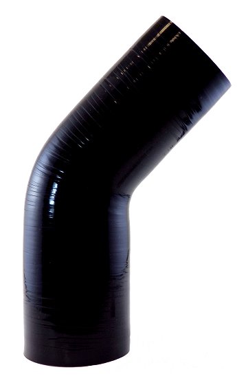

I had to recently replace my beloved ER charge pipe with a VRSF pipe due to relocation inlets and relocating the expansion tank with a replaced 335D tank. The intercooler silicon coupler 2.75 to 3 inch 45º unit was garbage... and would smoosh with the lightest of finger pressure. So I ordered two different hose companies: Silicone Intake Hose and Intake Hoses LLC.
First off, both hose companies had superior hoses compared to the junk hose that VRSF supplied. But the best and most heavy duty hose goes to Intake Hoses LLC.
Their hose was VERY firm and in addition to 5 visible thread layers, and the silicon in between those thread layers, there was also an orange interior silicone layer that capped off the inside and made it ultra smooth with zero surface imperfections. This was impressive considering the other hoses had weird textures and production scarring inside the hoses.
If you want a foolproof hose that ain't gonna burst and will have maximum pressure flex resistance during high boost... get the hoses from the INTAKE HOSES LLC.

To play the devil's advocate does it matter if it smooshes in? The pipe is pressurized under load, as long as it does not leak, I don't see how it could impact performance.
the VRSF hose has too much flex...it will bulge outwards when boost hits, leading to even more lag. If it smooshes inwards easily...like a balloon...then it will bulge outwards easily... the other two hoses are noticeably thicker and resistant to flexing...especially the Intake Hoses LLC unit...that thing ain't bulging for jack no matter the pressure.

This is the exact one I bought. I measured the length and used a razor knife to trim extra off.
See the orange layer?

Some flexibility is needed in hoses but most stuff is garbage as seen in most products today.
We use Aeroflow as it's tested to 300psi whilst remaining quite flexible and readily available.
Never ever have we seen a failure from one and I use them on my own car.
We also use Murray clamps to keep them in place as they are the best hose clamp available.

The Intake Hose LLC unit is flexible, but way more robust than the dildo VRSF hose.
