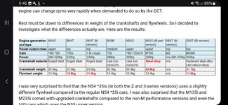

@houtan have you mentioned in the past that m235i n55 guys don't have this same phantom misfire as you? I just came across this post - turns out m135i and m235i n55's have a different crank than the n55's in regular 135i or m40i n55's.
This, along with the fact that changing fly wheels can buy you some more room may support my crank twist/harmonic theory as to why the n55 powered DCT 135i's run into this phantom misfire around 600whp... Different crank, or different fly wheel, different twist/harmonics characteristics to mess with the crank position sensor readings ...
