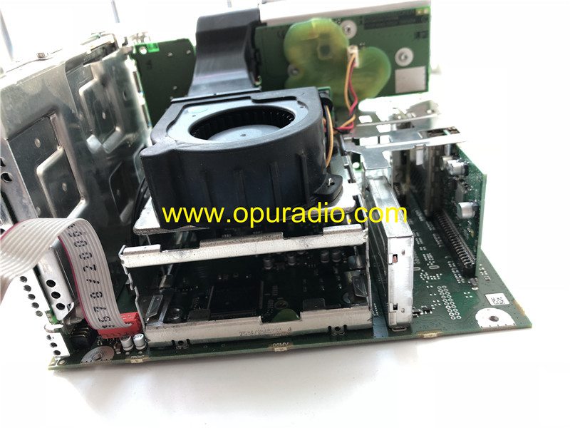

Hello.
Same problem.
It doesn't read CDs, it doesn't read DVDs, it doesn't recognize the music collection on the HDD.
Bluetooth music, Usb music, Telephone, Navi, Radio, Dab+ works perfect.
Also I checked my Hdd in other CIC unit and works perfect.
Could you please help me to find where is this chip on cic motherboard.
Model: Bmw E70 X5 CIC Pro+ Bluetooth Audio Combox
Thank you

Dear Sergejs,
I reassembled it because I needed the car.
I didn't take pictures of the electronic boards only the outside of my device.
However I found a link on the internet that has some pictures. If you can show me on them otherwise within the week I will open it again.
I am sending you the link I found as well as my unit from the outside.
Thank you in advance.
The link with photos:
And my unit outside rear view:

It's under allu heatsink. Search for TMS320....
