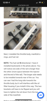

Thanks for the reply guys, what it looks like that rail was installed backward. After i read the installation from Jake and his pictures, he does mention about the the rail being directional and can be installed wrong.
